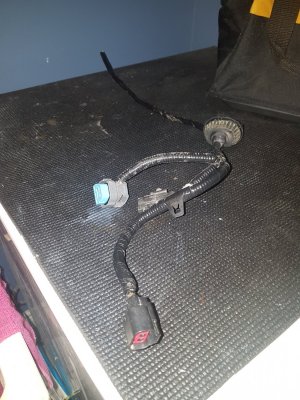

Went to the local scrapyard and was able to get all 3 connectors with about a foot length of wire on each.
20211120 120823
Cut and spliced the wires going to #3 and soldered the new one in place. Used heat shrink on each individual wire.

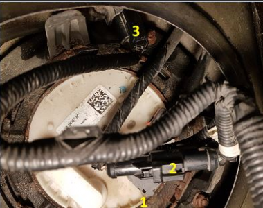

As the problem persists, last weekend I disconnected all 3 plugs while the engine was running, one at a time.
1638368687210
Plugs 2 and 3 did nothing, the engine kept running normally for 5+ minutes, no CEL's, no nothing. So those two are out of the equation, wish I've done this before replacing 3.
As expected, unplugging 1 did "kyll" the engine but only after 60 seconds or so. Fuel gauge went down to 0.

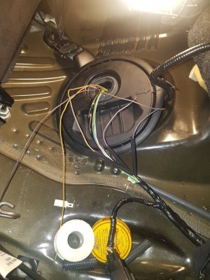

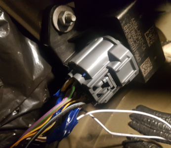

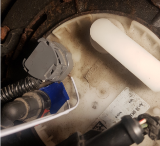

Yesterday I built the first FPMS (Fuel Pump Monitoring System) for the SHO. I added two LED's to be able to see if there is power going to the pump and coming out of the pump relay.
Added one right at the pump connector and the other one right after the relay (no wires cut). 1638369013897
1638369063626
Ran wires and placed the LED's at the front where I can easily monitor them. This is temporary so ignore the duct tape.
1638369143879
So, next time the car dies I just need to look at the LED's. Top LED is the one at the pump and the bottom one is from the relay.
