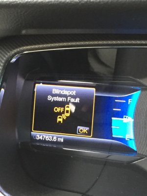

55c45657087457d45cfb6685aac7ab1b
Just applied the LMS v8 and these came up as well as a C1b00 code before tune. Thoughts?
9,045
4,390
Did this happen during the process of applying the tune, or did this error show up before?
The C1B00 is a code for the steering angle sensor, and the blindspot alert could be caused by a faulty sensor. If the car is running well otherwise, I'd try pulling the neg battery terminal for 30 min, letting the system reset, then see if the codes/errors return as you drive the car. Sometimes flashing a tune can pop up false codes, although usually a "communication" code or two (like a U1000) is also present.
