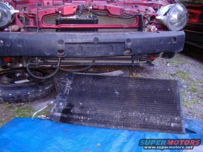

A fwe odd ball things that can be pulled out, all speakers and RCU. carpet material inside the doors, all venting pieces, heater core, AC unit, everything to do with the AC unit under the hood (maybe keep compres to keep same belt), airbags.
By removing the AC piece that looks like a radiator and sits in front of the Rad shoud remove maybe 5lbs (really light) but it "should" help cool engine down ALOT better.

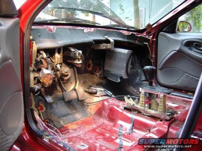

Cars 8 23 06 007
Basically anything you don't use or need can go. you can see the heatercore is gone and the AC thing is still their. But it's gone now.
In fact the littel cable you see lying near the gas pedal is even gone. That does something with the button on the floor shifter. It just means I don't have to touch the brake when pushing the button in ( but I always will anyways)
Cars 7 9 06 015
