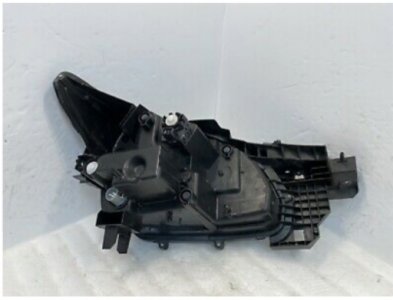

So I was looking to see if Mazda are using led bulbs that you can replace or built in like the morimoto and it seems they are doing it the same way as morimoto does it since there is only one plug on the housing C252da4b1ea7fb56a4d249ba329d047b
