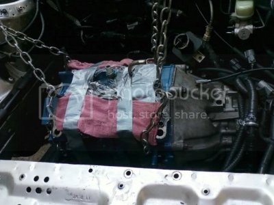

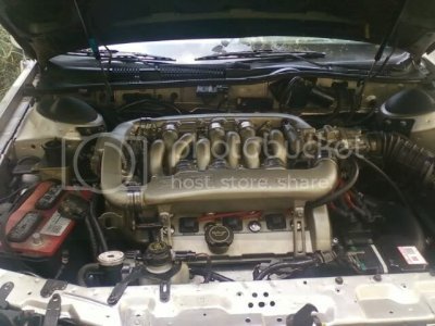

Just letting you guys know the engine went in without a hitch. I left the transmission in the car and swapped engines and so far so good. I left the heads off and installed the shortblock minus the accessories and went from there. To do this though requires a load leveler on the crane and merely a little patience while lining everything up. The alternator rectifier is going out so I haven't put any real miles on the engine but so far it's running good.

Sweet! Nicely done. By the way, my alternator went out last summer, and I was shocked about how expensive they were. I bought a rebuild kit from rock auto A LOT cheaper. And it wasn't too hard to do. The main failure item is the regulator, which is inside.
