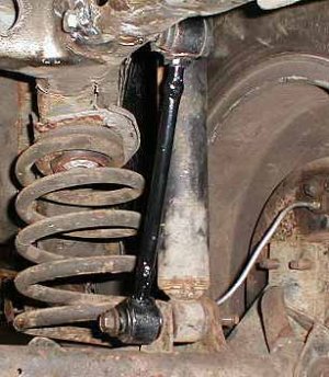

Sorry, I guess I wasn't specific enough. I wasn't recommending replacing the struts with an air ride suspension. I was referring to adding a small air shock(or 2) to the existing suspension. When you go to the drag strip, you could pump them up to prevent rear squat.
I got this idea off of a website for one of those 10 second turbo K-cars. He just welded in a couple mounts for the shock and installed it. Here's a pic of a solid brace installed but he said it can easily be replaced with an air shock. I think he only used one because he has an open diff. The car tries to transfer the weight from the front left to rear right. The air shock cross-loads the car to keep the weight up front.
Base rear strut
