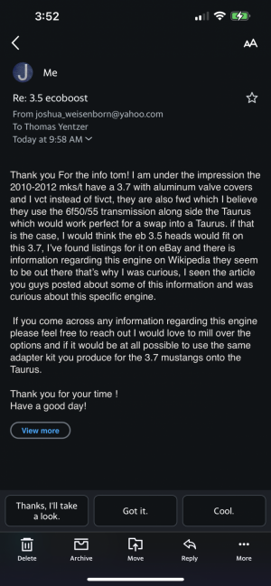

Looks like the heads are might not be interchangeable, I emailed super six and will report my findings,
For anyone wondering.
Update: Come to find out there is a ivct version of the 3.7 that came in the mks and mkt and from what I can tell it’s is the same head as the gen 1 ecoboost (aluminum valve covers with one cam phaser solenoid) I can look on pro demand to chart out the harness and compare this to our cars to verify if the sensor positions are correct theoretically even if they aren’t it should be relatively easy to extend the harness or put the correct sensors in

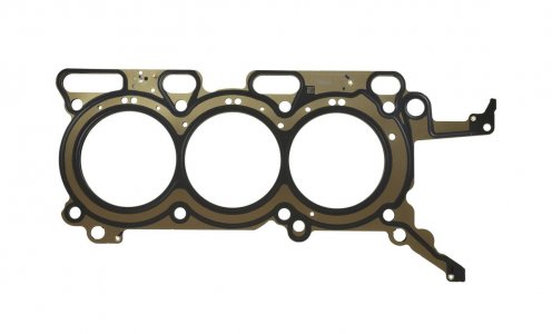

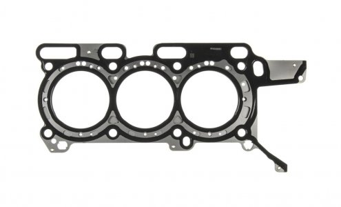

Yeah with a .100" difference in bore size, you definitely couldn't use the same head gaskets if you overboard the cylinders on the 3.5. Compression would be way high too. So custom pistons.
From the article: "The 3.5 and 3.7 do not use the same cylinder heads and the heads do not interchange. The Eco-Boost cylinder head is also different from the generic 3.5 and 3.7 cylinder heads with regards to direct injection and the exhaust ****** bolt patterns The combustion chamber is shaped differently and of course the presence of the hole for the fuel injector." "
The intake manifolds, heads and pistons are not interchangeable between naturally aspirated and EcoBoost applications. Driver side valve cover, fuel rails, high pressure direct injection fuel system, etc are also non-interchangeable."
Combine that with the fact that head gasket part numbers do not match (OE or aftermarket), head gasket specs don't match (including thickness), they do not physically appear the same (oval vs round cooling jackets. The fact that there are adapters to put 3.5 manifolds and turbos on a 3/7 instead of swapping top ends.
Using a 3.7 block with 3.5 heads would also mean the combustion chamber, head would overhang the cylinder bore making piston deck height and dome extremely important.

Super six’s article was referring to the ti-vct Version of the 3.7 , and not the ivct version,
Can we confirm that the engine I am referring to is this engine, because the guys over at super six didn’t even know the 3.7 with ivct and aluminum valve covers existed, and what would be the difference on this specific engine?
In retrospect I was also talking to cometic about a head gasket that is thicker to compensate for quench and compression ratio, they will make custom gaskets.

I guess at this point I’ll have to accept that a head swap wouldn’t work without a specific head gasket sense that would be the only feasible way to get the 3.7 to work in the Taurus due to the direct injection and coolant passages, because we can assume that the 3.7 is similar to the situation with the non eb 3.5 and is completely different, which is unfortunate because I would definitely love to entertain the idea for ***** and giggles

I can’t find any information on what head gaskets all of the aftermarket cylinder support or any closed deck guys are using either, they have engines out there that are bored and stroked already no? Why wouldn’t it be feasible to get a head gasket with the correct coolant ports on it, the only ports that are different are the ones by cylinder and the oval instead of circle, they have identical coolant passages otherwise, and the head bolt locations are the same, can anyone speculate why this would not work still?
