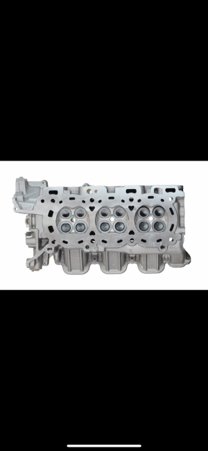

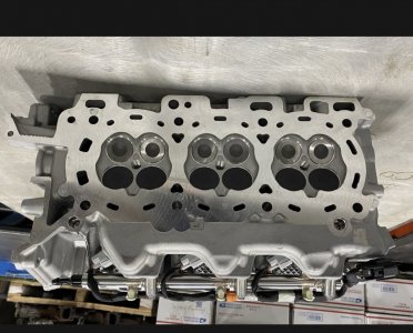

I would like a full definition of why they don’t interchange because if you look at the heads the bolt pattern and coolant passages are very similar between them
The only difference I see is the eb cc volume is larger
Thes heads are for the ivct Only
Not the tivct (what six was talking about in the article)
There should be absolutely no reason the eb head wouldn’t bolt up to the 3.7 ivct block and work with the proper head gasket

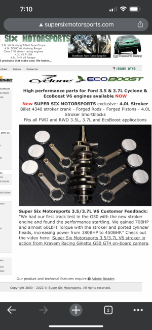

This is the stroker kid that they claim will work in 3.5/3.7/eb engines, I emailed them to get more information about this because I would hate for them to be falsely advertising this for the ecoboost when it will not work, if it does work that means the short block is the same and the heads ARE interchangeable with the correct head gasket, of course checking ptv clearance deck hight quench area ect. I’m not saying this is going to be easy BUT it should be possibleC807150F 4953 4487 B8F3 CB03E492E01A

There are different kits. If you notice, that kit has 8 different applications, there is no part number and the prices are listed as "from". So when you order that kit, you go down a list with them and tell them application and desire. Then they will select the parts that fit. A stroker kit does not change bore.
What is your end goal? Why are you so dead set on the 3.7? Is it the extra displacement? You can get a 3.5L block for $250. Complete motor for $1500. With your talk about going for bigger power and possibly bending a 3.5 rod, are you thinking that a 3.7 rod (motor that factory has 60hp and 100ftlb less power) has stronger rods? If your planning to do a motor build, I would get the 3.5 block that you know will work and do the bore/stroke to it rather then trying to start with a 3.7 that may or may not work and still needing to beef up components. Starting with a 3.7, your pistons are not going to be designed for the 3.5 combustion chamber and need replaced (a set from Super Six is gonna be $1000+). Seems like a lot of extra work that will only result in needing to spend more money.
For premise, I think it would be cool if it is possible, they use the same rods and different pistons, but from what I can find all 3.7 engines use the same pistons and the mustang engines are making good power so if it’s feasible why not entertain the idea?
the stroker kit does change bore I spoke to super six the only way to achieve 4.0 l with that block deck height is with bore it is a 3.780 bore, you would run into rod geometry issues and clearance issues with the bottom of the bore and I’m sure other areas if you did not.
I am currently verifying this but there will be a max stroke length that these blocks are capable of running regardless, and to achieve the 4.0 l displacement you would have to bore the cylinder to make up for this.
If you read their pdf file they offer “.004-.020” oversized pistons and the crank is a 3.60 crank which according to their catalog is the only one they use in this application so the only difference they offer is rod length and piston height that would be dependent on the application, so you would have to bore the 3.5 out to atleast the bore diameter of the 3.7 to even come close the displacement with their crank only is 3.6 l with the 3.7 l bore size it’s 3.9 and some change so do you see where I’m going with this ? If you had a 3.7 block already you could just drop in the 4l crank rods and pistons to achieve 4.0l
As you stated before the bore on the 3.7 is around .100 larger but they use the same stroke crank shaft stock.
With that being said the crank shaft would have to be 7mm longer or .276” longer to use the 3.5 bore diameter which is not a little amount, if the 3.7l bore diameter was used (or larger) this stroke length could be decreased to reduce rod to stroke ratio which would lessen the strain on the crankshaft and rods due to piston velocity, stroke promotes larger torque numbers because of the velocity the piston is moving at, which is not what this application needs, these engines produce great torque as it is and could potentially produce more horsepower up top with a larger bore, even if you gained 40hp and shifted the torque curve higher it would be theoretically easier on the drivetrain
You cannot determine displacement by stroke length alone. Almost all stroker engines are either bored or less displacement and for this kit to achieve 4.0 l on the 3.5 it will have to be bored.
I also talked to multiple mls gasket manufacturers and they will make a custom gasket for this application, so if that’s the case 3.7 l engine are very cheap. And a easy way to gain displacement so if you’re already building a engine you can mitigate machining cost by having a larger bore diameter from the get go, it’s never been done on the platform so why not maybe more some people would be interested if they knew all of the information available about these engines,
I understand that the trans and ptu are a weak link, so if the work is already done and the possibility is there why wouldn’t someone want to start with the 3.7 block for a radically built ecoboost if you are gonna change rods and piston in the ecoboost why not in the 3.7 .2 l sounds trivial but with the 4l stuff they’re seeing almost 70hp from .5l increase so the slight displacement change may be beneficial.

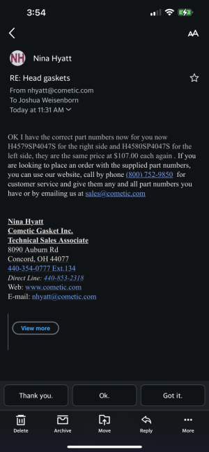

Update: Cometic might make a gen2 ecoboost headgasket for a big bore application/3.7 bore diameter @ 95.5mm, they are $107, and are made to order. Lead time is a month. They can’t confirm on gen 1 just yet.
Update: Cometic will make these head gaskets for gen one ecoboost, I will post the email down below if anyone ever needs the part #, they are 3.760” or 95.5 mm bore size .047” thick

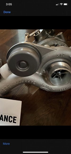

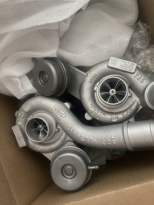

In response to the use of CR turbos, I chose not to go with them due them being clear that they do nothing but increase compressor wheel and due not rebuild turbos. To me that just didn't sit right. Why I went with TurboBay. All he uses is core, all other parts are new. He refuses to upgrade a turbo without a complete rebuild of all new parts, even wastegates are new.
i didn’t have that experience. My turbos were brand new, and when they went out this time the whole chra was replaced on both turbos,
