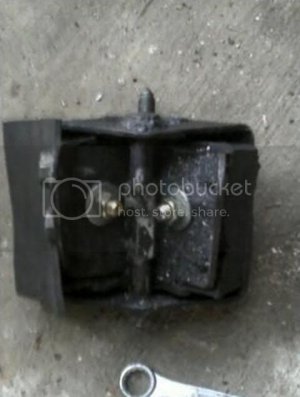

So I tore the rear motor mount out last night......
Motormount3
that don't look too good. Sooooooooooooooooooooooo, let the drilling commence!!

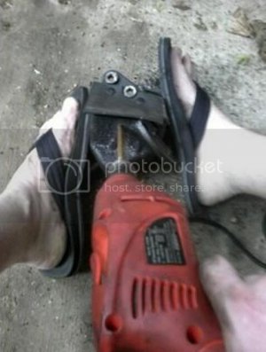

Motormount2
You know you like my clamps.....
That's one of the best things about being a professional cook...the indifference to burns.

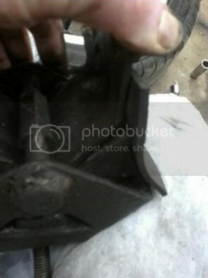

and the end result?

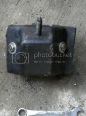

Motormount1
Motormount
I know...I didn't put the bushings in...but then, the rear motor mount mostly compresses anyway, so I'm not too concerned with snapping the bolts off. I'll get the front taken care of eventually, but even just doing that made a world of difference.
