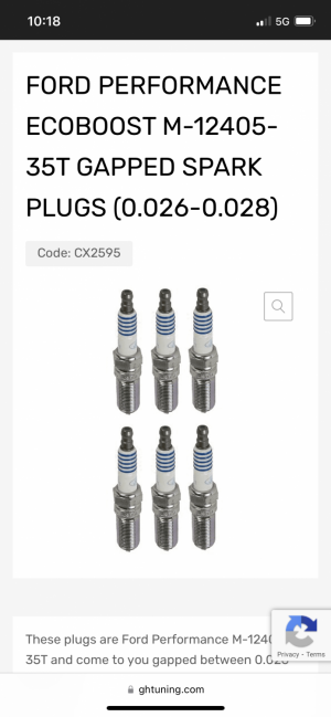

These are the correct plugs?
The M-12405-35T plugs are the SP542. They SP542 was removed from Ford's standard lineup and moved to their performance lineup and given a new name. There was an emissions compliance issue that doesn't allow Ford to use them as OEM in "average cars". The Ford GT uses them, but I think it is allowed under different regulations or something.
At least this is what I read a few years ago. Not sure how accurate it is.
that is correct. [Cue Chris Farley taking his shirt off]
