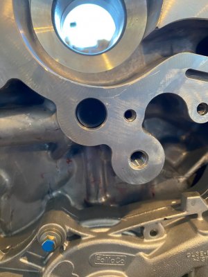

So something different between the blocks here..
Old block has a freeze plug on this portion just below the water pump and new one doesn't? Figure should probably plug that up before installation lol

Did you just end up plugging it?
Well, sadly, this was a project I had outsourced, so I didn't do it myself. Ryan made sure that was done. He took tons of photos of the build and I didn't realize that he hd sent me that pic I posted of my build. I never understood why he focused in on that spot, but since you put up your post, it made total sense. He wanted to show that he had it plugged, so that there is no question later.
Perfect. Yeah I was comparing the blocks and was like shit I guess I should do that too. So I'll have to get that done.
