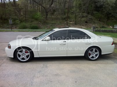

D7c5d962
these?
the +60 makes it a very difficult fit. even if you had the room, they would sit way deep in the wheel well.

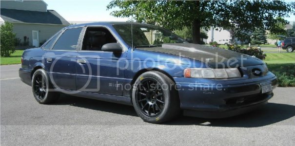

17x9 TD PR1 275/40 23mm offset
IMG 0118 1
17x9 Front (23mm offset to fit 275 slicks) and 17x8 rear (40mm offset) Team Dynamics pro race 1.2
it would appear a 17x9 fits with a +23 offset. i wouldn't do it on a street car though. it isn't practical. they would throw rocks down the side of you car.
what's the width of the SHO slicers ?
the slicer is a 16x6 with a +42 offset.

Where do you get your information from?
a 17x9 will fit with as little as a 32 mm Offset (and Barely stick out from the wheel wells) if you keep the tire size down to a 245 to 255. I run 17x9's up front with a 23mm offset, only so I can fit my 275 slicks up front.
For years many people have been running 18x8.5 wheels too, with the right offset.
