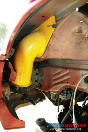

If you want it to sound faster, you can put in a K&N panel filter and remove the horn on the box in the fender well. It can be accessed by taking out the driver's side marker light.

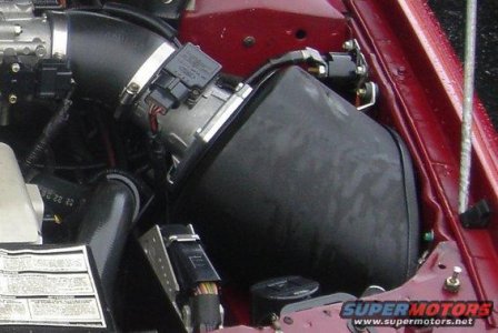

I have a old SHO Shop set up with a cone filter in a can. I gained about 100hp of noise, but none to the wheels. The stock set up works very well. You can gain noise by removing the silencer from the fender well.

Lets take the SHOshop setup JedHead has for example...if you notice it is basically an open filter intake. The filter then has a huge can/shroud covering it. It mates up against the fender where the hole is from the factory setup. Then a "cone" is bolted inside the fender. So air is pulled from the fender, through the cutout, through the now enclosed filter into the engine.
Now lets examine a stock SHO setup. There is an airbox with a panel filter. The airbox mates up to the fender where there is a cutout. Inside the fender is a "horn" that people remove. So air is pulled from the fender, through the cutout, through the enclosed filter into the engine.
