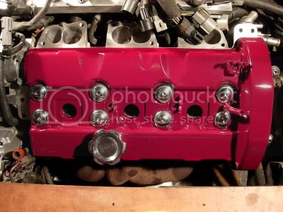

Paint work is all in the prep & takes time for the proper steps. If your time is valuable PCing is cheaper & more durable. I painted mine but I had the time as I was also porting. On a set of VC's I spent 6 hours over 2 days cleaning, scuffing, prime, bake, scuff, paint, bake, wetsand, paint, bake, clearcoat, wetsand, clearcoat, bake, polish & wax. Even being carefull I got a 'fisheye' & some dust on the frt VC visible surface that I wanted NICE! Then one slip of a wrench & I got a chip!
DSCN1608
