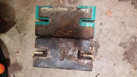

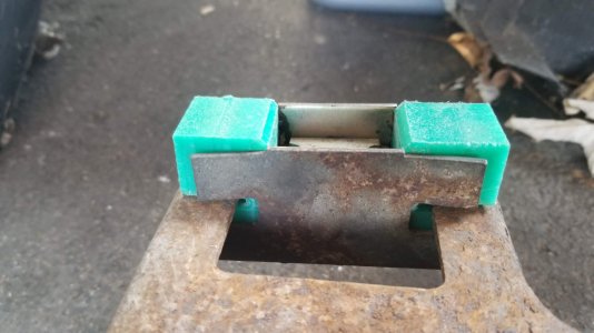

This is what I have. Mike @SHOSource made this for me. Send him a message and see if he remembers and could possibly make a run of these.
@kevinspann has a file for 3D printing that I think he'll share if any of you want to go that route.

The mount and bushings both look pretty straight forward to model if someone can provide the dimensions. I could print some prototypes in TPU for someone to give a trial run of, or if a less compliant version is desired, I could also print in ASA, ABS, or a carbon fiber reinforced version of ASA or high temperature nylon.
And if the .stl is available as suggested above, that makes it even easier to get some of these made for those in need.
