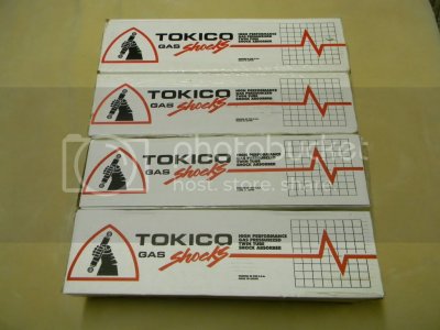

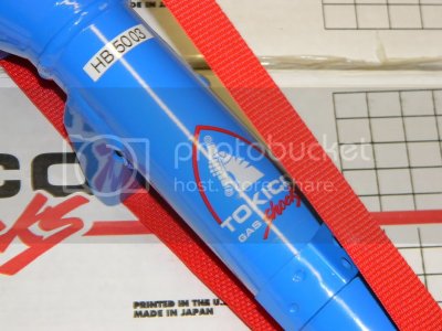

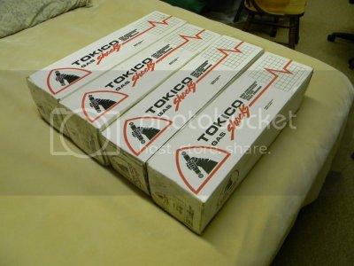

Just got my hands on some new Tokicos and god willing i'll be putting them on next week. I'm already running Eibachs and plan to remove 1 coil from the fronts while i have them off. What else should i or do i need to do when i put the struts on? Any upgrades i should take care of at the same time?
