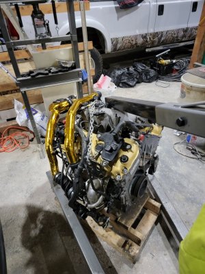

Replacement motor from Lincoln mks 2011 with 40k miles

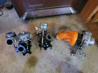

Rebuilt turbos with extended tip CHRA and replaced a hot side housing that was cracked.

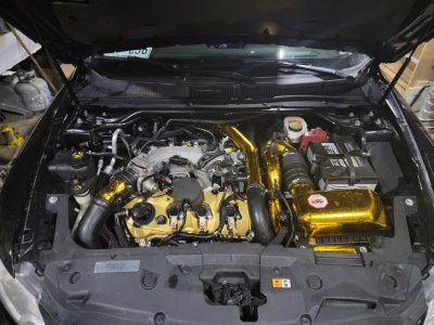

New t-stat, New water pump, New plugs

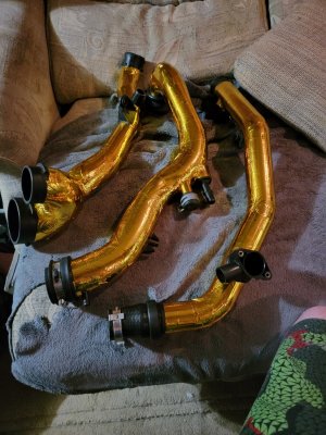

Wrapped all the intake and charge pipes with reflect a gold.
Added UPR dual valve catch can.

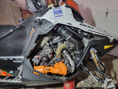

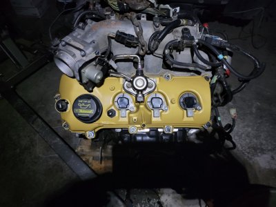

Painted turbos and manifolds black cerakote, painted valve covers with a yellow gold cerakote (did my turbo for my sled at the same time)

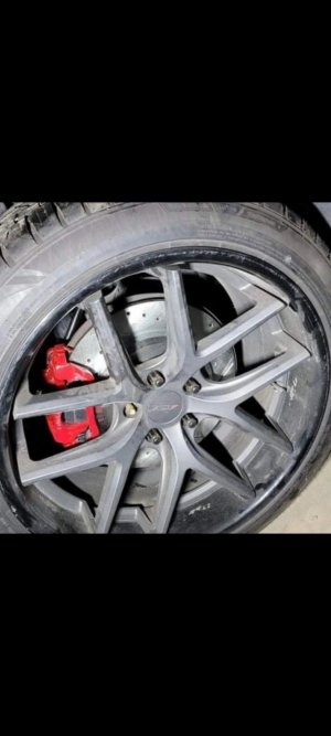

20" TSW gray on black rims wrapped in sumitomo all seasons

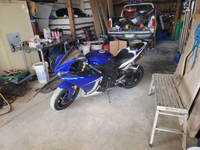

Also picked up an R1 last year so I've been riding that alot.

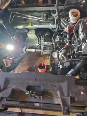

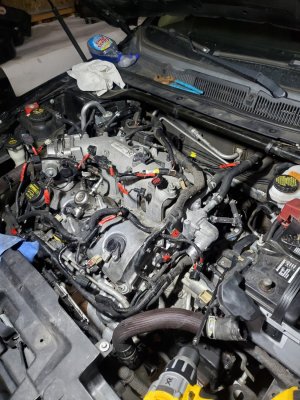

I was pretty annoyed when I left the forum so I didn't really take many pictures of the process because I didn't care to share it here. But I can confirm that you can most definitely do an engine R/R out the top without removing any of the coolers or the front crash bar. I believe there may be one or 2 other people since that have also done it out the top.

Also need to have the rims repaired as my ex did a number on them with some curbs.
