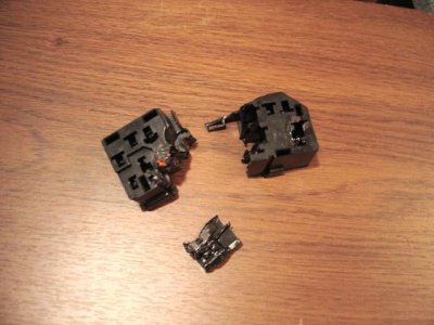

On my '90 I had to completely replace the connector and the switch. The plug had melted so far that it actually had charred and crumbled apart when I tried to remove it from the switch.
Melted20plug

It looks like it was the same termnials that overheated on both of our switches. I have been wanting to look at the schematic to see what circuits got so hot.
Yes they are the same terminals. Almost all Fords of this vintage have problems with the ignition switches; there was even a big recall in the early to mid '90s to replace them on most models because of fire hazards. The larger pin on the right in your pic controls the starter solenoid. The 2 in the middle feed fuses 5 and 9. Fuse 5 is a 15 amp fuse that runs most of the electronic systems in the cabin and fuse 9 is a 30 amp fuse that is for the blower motor.
