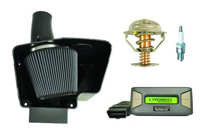

The best bang for your buck is a tuner package, no doubt! Here is what I have on mine:
Q80 w400 h images ePIM original P04 LPP350102 main
2015 SHO STAGE 1 PERFORMANCE PACKAGE
PLUS
Q80 w400 h images ePIM original P04 LPP630000 main
3 BAR MAP Sensor
That combo will add ~85whp/90wtq, and keep all of the smooth driving characteristics that you loved about the car when you bought it!

Couldn't agree more! I started with the above mentioned parts. By far, the biggest "bang for the buck". The only thing I noticed (aside from the OBVIOUS power gain) was a bit more intake/turbo noise. Both of which were welcomed additions.
