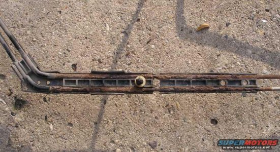

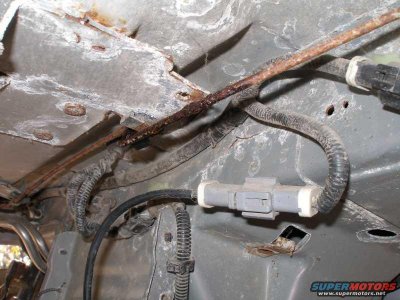

I just took the lines out of my '96. Above the gas tank going to the RR and under the drivers seat where the plastic guard is were all rotted away. This is something every one should be thinking about.
Under the drivers seat
Rusty brake line 3
medgraphsho
Bill T.
Jun 11, 2007
337
29
Bridgeport, CT
I can add to this... My drivers side brake line was just replaced at Midas, front to back, for a respectable $230 out the door.... I will post pics of the brake line as this is a very common problem on all Taurus's.... Check them now before the snow/winter comes and your out of luck 1 day
