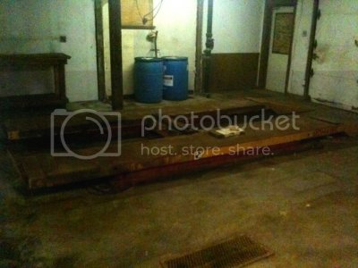

Next question. My new shop has a lift, but its a drive on older style. Has anyone ever pulled an engine on one of these and how did you do it?
Photo1 2
Whydah91
Nov 12, 2011
77
Virginia
I love those lifts, for rear wheel drive cars. Going to be a bear to pull a Taurus engine with that type. Ya have to move the front suspension to drop the engine cradle, which I'm sure you know. Ya could just about do it on the ground as easy.
