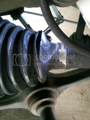

After some more playing around with it, I realized that the sound does NOT go away when I push in the clutch. It seems to be present when I'm going straight, worse when I turn left, and not so bad when I turn right. I finally had time today to jack it up and this is what I found on the passenger's side...
2011 07 30104303
Gonna try to grab a new axle today. This should be the problem, right?

I ordered up a new axle. I'm having a friend of my fiance's family do the work this coming Saturday. I'm realizing now just how many of my tools I still have to pick up from my parents' house. It irritates the crap out of me having to pay someone else to work on my car, but luckily he's only charging me $40 to change the axle and do the oil change (with me providing the axle, oil and filter). This should be the source of the irritating humming sound as I'm driving, right?

Took it to my fiance's mechanic (he's a friend of her family) to have the axle replaced today. He called me this morning after looking at it and said the wheel bearing was shot too. I told him to go ahead and replace it. Picked it up this afternoon. Cost me $150 for the labor to replace the axle, the wheel bearing, labor to replace the wheel bearing, an oil change and balance the tires. I thought that was a pretty good deal. Picked it up and he told me the carrier bearing was going bad and would have to be replaced soon. Left the garage and got about 5 miles away and it stopped going in any gear. I called him up and he came out to where I broke down and took a look at it. He said the carrier bearing went and it would have to go back to the shop. He's going to get the bearing Monday afternoon and he said he should have it done Monday evening. Of course it had to downpour while all of this was going on. Got it back to the shop and hopefully I'll have it back Monday night. Guess I'm driving my fiance's Hyundai Accent to work on Monday. FML
