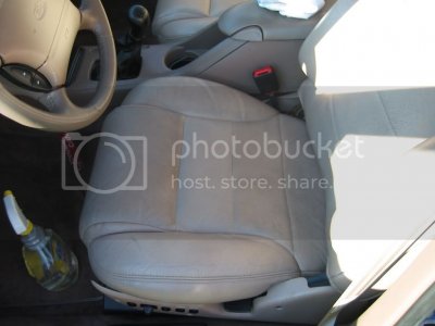

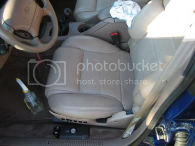

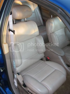

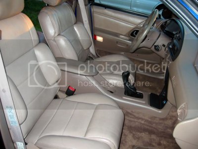

I was inspired by this thread and decided to stop off afterwork and pick up some Simple Green and leather conditioner. But when I got home, the wife was waiting with the kids to go grocery shopping. I was able to talk her into letting me stay home with the kids while she went shopping. As soon as she left, I told our 7 year old to watch the baby while I ran out to shop and took out my passenger seat. I brought it into the house and begain to work on it. After about 2 hours, 2 dirty diapers and four beers. I was done. See the pictures below Before After

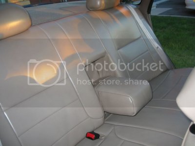

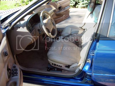

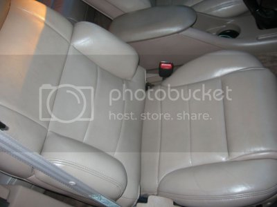

I just cleaned the leather in my new blue car. I was going through autopia and found that many people recommand Woolite (1 part Woolite, 6-8 parts water) as an effective leather cleaner.
It looks like the original owner had some sort of blue seat covers on the front seat and the fabric melted onto the leather over time, leaving that jean like texture on the driver seat.
Anyway here's what it looks like before I started:
IMG 5164
Cleaned a bit, you can clearly see the difference:
IMG 5167
Results:
IMG 5168
The rest of the interior is much better, gave those a quick cleaning as well:
IMG 5172
IMG 5175
IMG 5180
I'll use the Lexol conditioner and mink oil tomorrow. I want to put those on while the interior is nice and toasty.

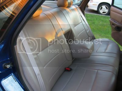

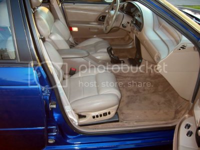

Got done with the Lexol and the mink oil. The oil also gave the leather a shine that the Lexol didn't.
The leather itself is a lot softer than before, but still very obviously not high quality leather by any means. I'm pretty happy with the results though.
IMG 5185
IMG 5186
IMG 5188
IMG 5191
Looks like the "jean like texture" is actually the coating of the leather, only melted and wrinkled... Doesn't look like it'll be coming off at all.
