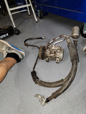

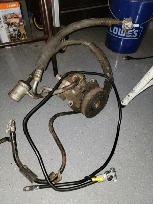

So, I picked up a pre-made, 55" negative battery cable w/pigtail from a local NAPA store; also, stopped by my brother's house and picked up an A/C compressor I got from Fred some time ago.
Ac comp battcable

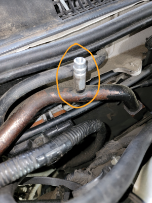

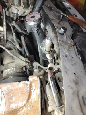

Question: I can't find a Schrader valve on this existing setup, so how can I empty the refrigerant? I have no idea if there is any actual charge remaining, but there very well could be.

This entire piece is the valve. There isn't a serviceable schrader valve. Take a wrench and turn it off the line.

That compressor you picked up appears to be missing the clutch, so if you plan to install that compressor on your car, make sure to install the clutch before you connect it to the car. Looks like it would be a real pain to try to install with the compressor mounted in the car.

It's very doable. Getting the nut loose to try and remove the clutch is a pain. Just installing the clutch isn't bad at all.
