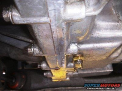

How come my trannys seem to have a small leak right there along the crease of the case in the pic above (would be vertical in that pic)? Is there a seal there or is it oil/fluid coming from somewhere else? Both of mine are dirty right there with what looks like fresh oil or fluid. Looks like it may be where 2 halves are fitted together.

That's exactly what it is. Maybe the last person inside your transaxle(s) didn't use the proper anaerobic sealant?
