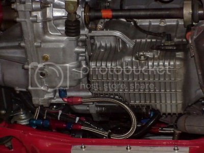

Don't fear the drain plug Ron, mine's huge, ;) but is now somewhat redundant because of the scavenge fitting for the cooler pump.
