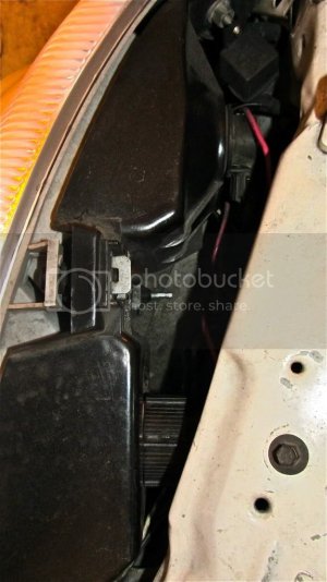

A few weeks back, I was severly frustrated as I had searched the forum for what seemed to be hours for help in figuring out how to adjust the headlights down on my SHO, and I found nothing of use! My lights have adjusted themselves upwards over the past year's time, and the guilt of seeing people in front of my SHO flick their mirrors down made me want to address this issue.
So, here is a picture of the 4mm hex/stud you need to turn to move the beam up or down
Headlightadjustment

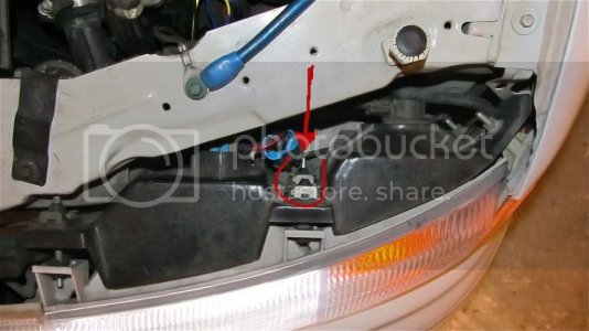

for reference, here is a picture of the passenger side,
IMG 0684
My headlights are aftermarket "Light depot" units, so I am not sure if this is the same for stock units, but I turned the wrench counter-clockwise to lower the beams, and clockwise to raise them. I am sure this is the screw you need to turn to make the up/down adjustment, so play with it until you get it right, I used a 4mm socket with a 1/4 drive ratchet and it was very easy as I parked about 10 feet from a wall on even ground and lined the beams up.
Hope this can help someone!

Thanks for the little write-up. I did mine a couple of weeks ago after I sanded them down and polished them.
Just to add to your adjustment write up....the left to right is the 4mm bolt on top of the headlamps near the fish tanks.

Eh, they're not the worst I've ever done, but you need a 1/4"x6" (or 3") extension if you're gonna do the left/right adjustment.
