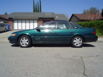

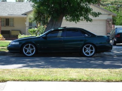

Here's how much I lowered mine.
:biggrin:
ha, you car stock looks lower in the front then my car on its eibachs:rofl:
EDIT: unless that first pic isnt stock and if youre atx that explain it. My car mtx + lighter hood = sits higher up.
