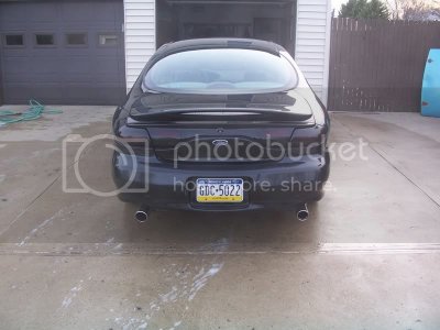

I put about 3 coats on my tails. I didn't use any clear coat and they still look glossy even the the picture doesn't really show it. If you want them really glossy, then you will want to use clear coat. I think they turned out excellent. I didn't sand them at all and I don't it is absolutely necessary unless there are imperfections. I just cleaned them a few times with Eagle One aerosol glass cleaner, I think. I highly suggest taking the tails out of the car. It is loads easier. I have done 3 sets of tails, 1 set for my car and 2 sets for friends. I did both of theirs on their cars and they didn't turn out as good as mine did(I had an extra set and i did them off the car). Check you local laws and see what it says. I have not had any legal problems, but since I got an extra set I can always swap them back. You can also purchase them on www.jegs.com Its VHT Niteshades and its $12.99 a can. Heres a picture of my car, not a gen 3 but you get the idea...:thumb:

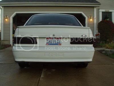

I sanded off the Ford logo on my sidemarkers, then nightshaded and clearcoated them:

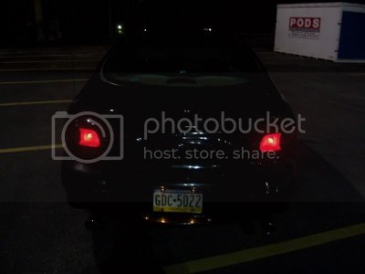

first , spray with confidence. if you spray like you are afraid to mess something up you will. on first round I had some drips and splatters, then on advice I used 1500 wet sanding paper before clear coat, tried to sand out the drips and I guess I was overaggressive b/c the haze that was left did not wipe away. I found out later that was probally okay just to wipe more . long story short I started all over again and the second round the spraying of niteshades I executed better so it was smooth. b/c of that I opted to skip the wetsanding and I just clearcoated. I guess it ended up being about 3 coats of NS and 2.5 clear. now I've heard of stories of people in VA getting tickets , and mine is dark but damn it looks good. I still have some overspray to touch up but I am very pleased. so my advice would be , if the coating looks smooth, save a step and clear coat.
I also took the time to remove my non functioning trunk lock and finally get around to properly affixing my tiny V8 badge. I got lucky when 5 minutes into my search for something to use to attach it to the inside, I looked in my toolbox and found an anonymous piece that looks like it was made for job !
Funmart notice how easily the red shines through when the brake is applied. Its technically illegal around here but I just don't get it, its red when it needs to be so wtf? :shrug:
