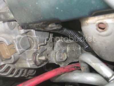

Okay all- finally got a (very windy) day to change the alternator. I have the belt off and all but ONE bolt off. It sits under the bracket on the intake and I've got NO room to maneuver. It's a 15 mm bolt and there's stuff in the way so I can't get an extension in there to get some leverage. I hit the engine on one side and well...some hard lines and the front of the car on the other.
Attaching a picture- I need any advice on tools or tricks you all have. I'm hoping to get this taken care of today but I AM going out of town soon so it's not an emergency yet but...it will be fairly quickly.
Thanks again- Ashley

I guess you're just using sockets? A rachet wrench might be helpful here.
Can you get a socket on there with a little range of motion or none whatsoever?

I have ratchet wrenches...problem is where the alternator was connected...I guess it was a ground wire you can see in the picture it looks like it's to the left of the bolt- actually it's ABOVE the bolt. can't get a ratchet wrench in there because it hits that.

i used a couple long extensions and a swivel-socket

Ahh yea I see that. Does a socket wrench with a socket on there clear that ground bolt? Probably hits that hard line though doesn't it.

Yep- that's the problem. I got some offset ratchet wrenches. About to go test to see if they clear.

What about just a regular open end closed end wrench? The closed ends are usually angled so you should be able to clear it. If you need leverage then slip a peice of pipe over the wrench, just be careful not to over do it.

Offset ratcheting wrenches worked. Now I can't get the damn thing out of the car. Just the 3 bolts right? Two on the left, one on the right?

FWIW, that post above the bolt you were having a difficult time with is not for grounding. Don't forget to connect the wire to that stud before you connect the battery.

Yeah the post on the alternator is the B+ terminal... I have arc welded wrenches on that thing by not putting it on before the battery terminals.
