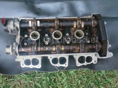

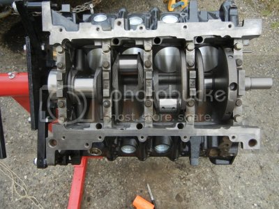

The best product to use to clean engine parts is Chem Dip. It's sold everywhere in gallon cans. I use a paint brush to smear it everywhere, let it sit and then rinse it off. It takes off everything and fast too. This is how this head went from this:
SSPX0049
To this:

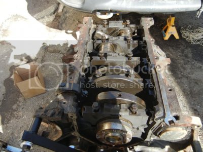

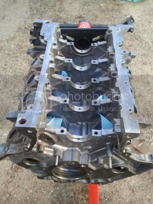

I opted to hot tank... But I had a ton of gunk/sludge buildup. Another cheaper option would be boiling hot water, TSP, and a rubbermaid bin from wallmart. Give you a hot caustic solution that eats most of the crap off.
Before:

After:
