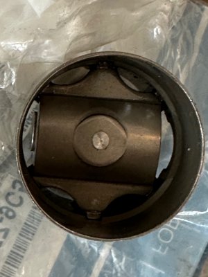

Ford AA5Z-9C587-A​
Above is the number from Ford. I bought a new one at the dealer, I paid 10-12 dollars more than I could have gotten it for online. But I got it today and installed it.
Below is the old tappet, you can see the area were the fuel pump sits and it's wear spot. The new piece was completely smooth in this area.
Right now the noise seems much better, I'm going to wait to see if the noise increases again before I order a new fuel pump.

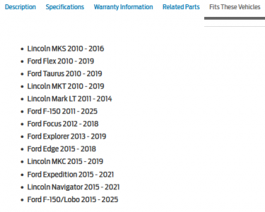

Where did you pull this from? Trying to source the part as PM and looking at Tasca, it says it only fits 21-23 F150 2.7, 3.3, and 5.0. It also says it won't fit the 15 SHO.
Honestly, I don't remember where I found that. I ran into the same info as you. I kept searching and found what I found. The online Ford parts catalogs are sometimes quirky like that.

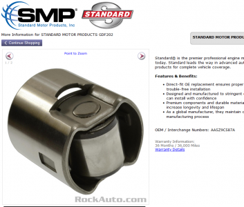

Here is an entry from Rock Auto.

Awesome. Thank you. That lists our application and gives me a little better feeling about fitment.
FYI, the bag the part came in said the part was manufactured in Germany. In case you might be wondering about quality.
