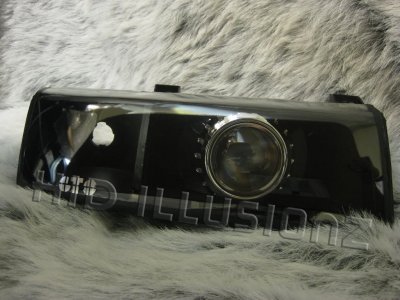

Well I was browsing another forum, I am thinking of upgrading my f-150s headlights when I found a company who does proper HID projector retrofits. I also stumbled upon the fact that they have done someones gen 2 SHO all ready.
Ionz1992 1995fordtaurusshofx35e46revised02
http://hidillusionz.blogspot.com/2010/07/ford-taurus-sho-fx35-hid-retrofit.html
I thought I remember seeing something about this before but I am not sure.
It's surely worth looking into. I wonder what they charge?

His just sold for $300. I was looking into doing mine. Need to build a vacuum forming machine to to mold the lenses into plexiglass. Then just get the parts. There are a few retrofitters out there. Check out HIDplanet.com for a lot of how to's. I'm reading up.
Also Vnuk1 is doing some not sure if he's doing well or not.
http://www.shoforum.com/showthread.php?t=113343

Yep, that's my buddies company and those are my lights. He also has my Gen 3 retrofit on there. He'll be working on another set soon.
Do you mind me asking how much they cost to have done? You can PM me if you don't want to post.
