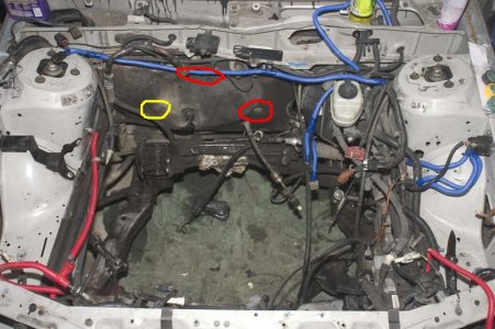

I'm sorry, not bolts: nuts. The studs are attached to the HVAC unit and they are poking through the firewall with nuts on them. They are pretty easy to find since there isn't a whole lot coming out of the firewall. As for location... let me find a picture to post.

Okay, the yellow region I am sure of, the red I think is correct. Nontheless, there are only three nuts on mine to take off.
