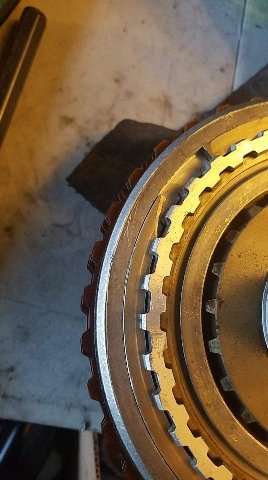

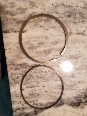

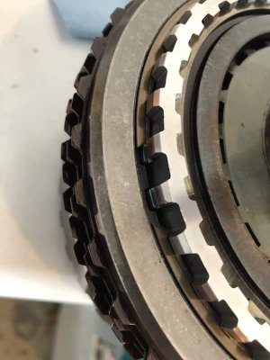

So the major issue with these is the 35R drum and the snapring, the drum is aluminum and under high loads it flexes and the snapring starts to come out of the groove. With upgraded clutchs. Snapring. And some high pressure you can get it to hold pretty well, I have cryo treated everything that can be treat internally as well. I have attached a few photos to show the differences you will need to take the pressure plate and cut a bigger groove in it and cut a bigger groove in the drum but it works well so far.29d065b335e566d457e781db3e320eddE2676790382814613d4c10c1a490e2a7C57c40c1e14d112cc467cd23b392c4af

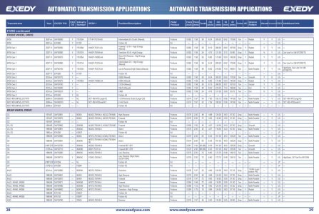

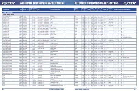

OK, after doing some research, looks like the Exedy kit is considered an OEM-level replacement. I've attached some photos of their catalog with references to the various transmissions. Looks like they list a Gen1 6F55 (2007-2011) and Gen 2 6F55 (2012-up). Here are the various kits with the Exedy part numbers, Note that the Industry part numbers are all K115F (as was mentioned), except for the Gen 2, not really sure what that means...
6F35 EFK429
6F50 EFK 282
6F55 G1 EFK283
6F55 G2 EFK422
PdtPeJHPh0cUEawidth1024height672cropmodenone
WNuWiWMUKvr4Nkwidth1024height688cropmodenone

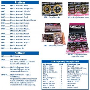

But with the prefix of EFK, that's basically their OEM kit. A suffix of HP1 or HP2 would be their performance line, which doesn't look to be offered in the 6F55.
RuV6yz yzV8AkjUwidth652height647cropmodenone
The GPZ Raybestos friction clutches are their performance line, meant for high power, commercial and racing applications.
