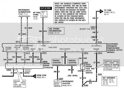

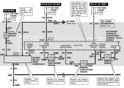

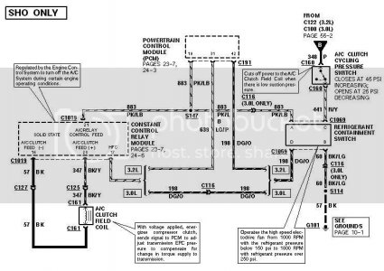

Are you handy with a multimeter? You need to start getting some voltage measurements. What year is your ATX? I will post wiring diagrams of the HVAC system for you.

As far as the heater fan coming on when you hit OFF - Sounds like the Blower Moter Control Module behind the glove box. The fan belt might be seperate.
