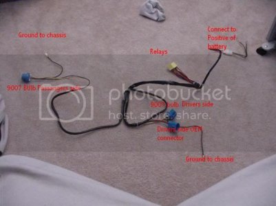

Was attempting to install this headlight harness but have no clue where to plug it in. I've looked for over an hour but don't see any way to unplug the lights and plug in this harness.
I have brand new lights and really want to isolate them for max light - have been driving while blind for too long.

Your picture driver/passenger labels are backwards.
Unplug the stock connector on each bulb
Plug the new plugs into the bulbs and attach the grounds to the core support
Plug the passenger side stock connector into the harness
Mount the relays somehow if you want.
Connect harness to battery positive terminal.

I was wondering how this helps if using the original light plug. (I started to do it this way but decided to ask before frying the car)
The picture I took from another forum. I was going to install it the opposite way.

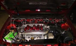

I'm stoked... the car looks like crap. It's old with a saggy rear end and much of the clear coat peeled away. But the engine looks sweet, interior is O.K., maintenance is up to date and the wife hates it!

^Woah nice engine bay! :thumb:
Have any higher resolution photos?
