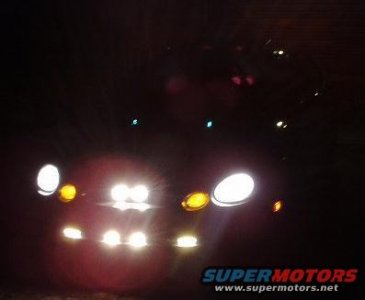

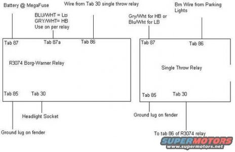

Add a couple of lights and a relay equipped high wattage harness for the headlights themselves. The stock bulbs will even be brighter with the harness upgrade but most I have seen will not operate the DRL's. Below is a diagram I made of mine that allows the DRL's to still operate. I set it up so should any rrelay fail I still have headlights, just at the stock levels of power.
Nitesho
Wiring headlights
And here is a shot of the difference. Kind of easy to see which one has the bigger wire but same size lamps (Silverstars).
Wiring headlights

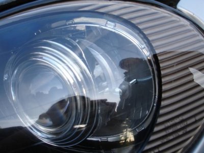

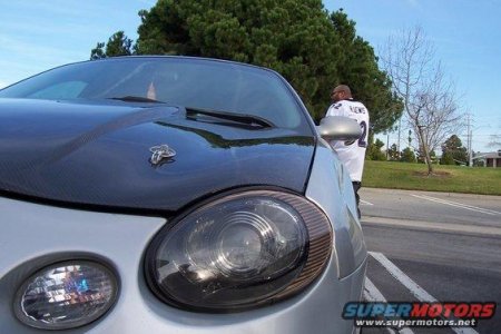

more HIDs with projecotrs.
I like variaty, so the red has the S2Ks (low beam only) and the dark green one has Bi-xenons E55s (high and low beam) and has anyone completed that shroud yet on the other gen3 SHOcontinental. What kind of projecotrs are they. Did they come out of a car or are they regualr hellas or something?
