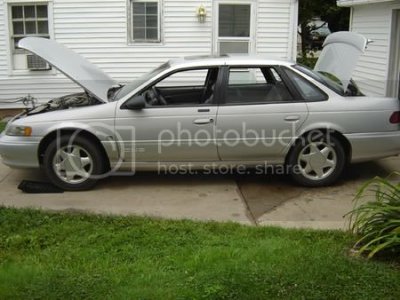

Apearantly its quite common, but i got them replaced.
Before (stockers w/1 LIVE coil broke off each side):
12 15 05 Meet
After (Moogs UNCUT for now):
RearStrutProject025
