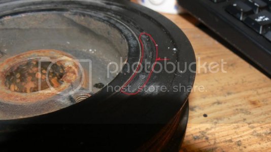

Let me get a pic of the pulley I have, and I'll show u where it seperates... if its cracked then its probally toast..
Pulley
There is rubber in that circle there... you should be able to see if it's seperated or not. The one's I've seen have all had the outer part push inward towards the motor. You should be able to see it if you turn the wheels to the right all the way, and pry back that cover a hair.
Edit: Grab a small straight edge... or a razor blade, and you can lay it across that little "valley" there and see if they are even as well. That edge is the same "height" ... at least it is on this one.

I agree I wouldnt call it cank cancer... like Eric said the rubber likes to come apart! I have seen it before, and a new crank pulley is what the doctor ordered!
