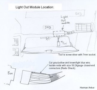

That link did not work, no image. Please help
Really? I just clicked it again and it showed just fine.
Let's try this instead:
Lampout
The basic gist of it is you cut the grey/yellow (G/Y) and brown/light blue (B/LB) wires coming out of the lamp-out module above the glove box and terminate them safely so they don't touch anything.
If I properly understand the way this works, I think that this disables the headlight functionality of the LOM, while still leaving monitoring of the other lights. Unplugging the module altogether would disable the entire lamp-out system.
Lampout
Regards,
Jon Heese
Still no pic but I'll try your instructions. Thanks
