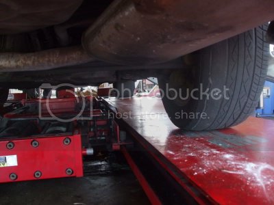

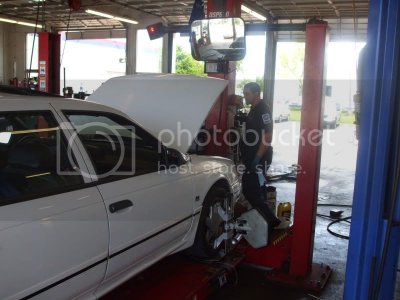

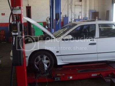

Me and rcsavage got the 60K maint pretty much done, well at least the important parts. Drove it a while. I fixed the squelling tie rod end. Took it to get an alignment. Look what I found.
Not pretty, I need the special Taurus/Sable adjustable alignment parts to fix it. The cambers in the rear are way off. So far when I researched it online, partsamerica sells a bunch of the parts. What would be the best to get for a camber thats 2 degrees off? I'm thinking the parts made from Northstar. Here are more pics of the alignment.

Just get a set of the Ingalls adjustable control arms from SHObros, here:
http://www.shobrosgarage.com/product_info.php?cPath=156_154&products_id=343
They're probably cheaper in the long run than trying to fix that some other way, and they give a LOT more adjustability (and easier adjustability than the stock pieces) to the rear wheels. You can set camber and toe with these nicely.
First, though, I'd look around to see why they're off so much. Usually that means that either a spring is broken or sagging or one of the control arms is bent. Should be reasonably easy to spot what's wrong when it's on a rack, I'd think. If it's been in an accident it could be more fundamental than that, but in any case the adjustable control arms can get things back where they need to be and are a nice upgrade.

2 degrees maybe asking a bit much from the eccentric bushings. Like Shoaz said, check for bent/broken parts first then get the control arms. You and your alignment tech will be much happier with them!

I have the control arms and I love them, they are very beefy and they wont flex like the GTp control arms. The eccentric bushings might not give you the adjustment you need.
