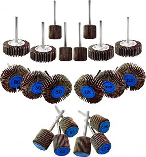

what bit are you using? I'm going to install my dowels tomorrow and plan to do the same.

Actually, since I'm not really trimming any of the aluminum and just trying to get the spacer trimmed to match the existing runner dimensions, I just used the small dremel flap wheels...
It really did a great job of cutting into it without going hog-crazy. That white is just the phenolic material dust, LOL...

I used the smaller 9/16" drum instead of the 1 1/4" ones...

Nice, I'll add that to my Lowes list for tomorrow.
