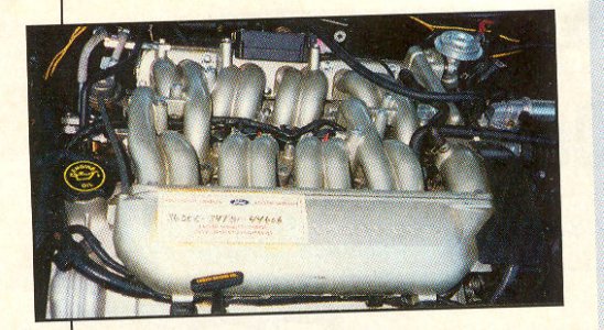

The bottleneck in the V8 intake system is where the sax goes into the fender. The intake is not a true dual-runner system like the Gen 2, but the problem with the V8 intake is not poor flow at high rpms. The problem is that it does not (and cannot) achieve the dual peak of torque and HP that the V6 can, because there is only one runner per cylinder in the V8, hence there is only one point of peak resonance.

Of course this begs the perennial posting of the real V8 intake.
13,265
Is that real? What's the story with that? A true dual runner setup would be sweet on this motor.

Illinois
I have seen it on the shelf off the motor. That is all I can say.

Any idea about the difference in performance as compared to the current setup?

....kinda looks like the intake on the 4.2 V6 in F-150s.....seen pretty much the same thing in Windstars and 3.8 Mustangs......
