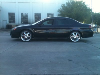

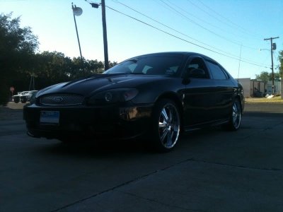

Anyways I have a 05 Ford Taurus Se. Its a 3.0 ohv (Vulcan) edition with 63k on the clock. Nothing is wrong with the car at all. Pics of my car (if you care)

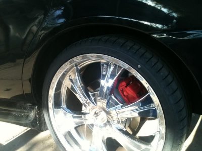

I have already upgraded the brakes and suspension to accomadate.. I do still need to do the 13" front brakes tho haha.
Cargo Coils in the back to help with the 400lbs in the trunk
Photo1 1
Rear Disk Brakes upgraded to 11.6s
