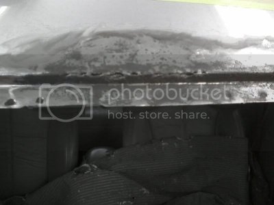

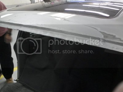

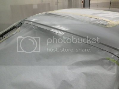

I had some nice windshield rust on the top of the windshield of my 97 SHO. It didnt look bad until i took the windshield out, and discovered that there was more than I bargained for. Rust all over the whole lip, i'm surprised that the windshield didnt leak because the adhesive was not even attached to the lip. After about 3 hours of sandblasting and brazing the pitted section of rust, i filled it with some all-metal filler, and finished it with polyester putty, primed it and painted the lip and about an inch onto the roof panel. I have to paint the roof this week where the bodywork was done. I am getting a brand new windshield installed tomorrow for 150 :) Anyway I just figured i'd post some pics of the repair in progress, and they are kinda crappy taken with my camera phone. Anyone else ever run into this??
0917081353
The rust after grinding off most of the crap

Skim coat of All-Metal filler while it was drying

The completed repair, now I just have to paint the roof!
