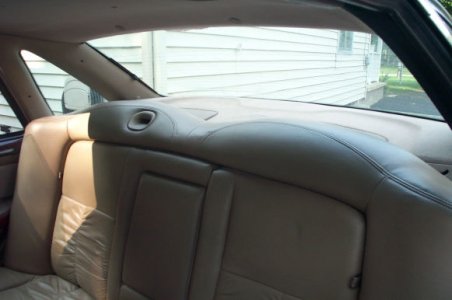

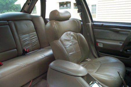

i ran into some odd problems with the gen III seats. my front passanger seat fits all the mounting holes but the drivers seat did not. i'm wondering if the seats i got had a bent mounting bracket. also the rear seat back fits fine you'll have to build them up in the back as the rear of the seat sits lower. if you want the upper part you will have to custom mount it. i actually installed mine so that i can have a passthru. work nice but sawzall is required along with custom mounts and carpeting..
few shots
Newseats1
my 91 is a collection of sho parts. 91 with 99 seats and a 93 rear deck.
Newseats2
few shots
Newseats1
Newseats2
