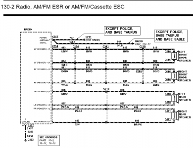

I have a 93 MTX with the stock factory premium speakers , that I’m in the middle of replacing with a set of aftermarket speakers but I can’t seem to find the right diagram that shows the color speaker wires that I have that tells me which is the + and - wire, cause there’s nothing that’s marked on the stock speakers that shows which is which so I wanna make sure I’m wiring them up to the right splice!

Google "9V speaker test". There's plenty of YouTube videos that'll show you how to do it. Essentially you hook the wires to the positive and negative of the battery. If the speaker pushes out it means one thing and if it sucks in it means another.
I've used it before but forgot which is which.

"Premium Sound" only came in the Sable, the door panel speaker grilles say premium sound instead of "stereo".
All levels of sound use the same colors for speaker wire though. 1993:
