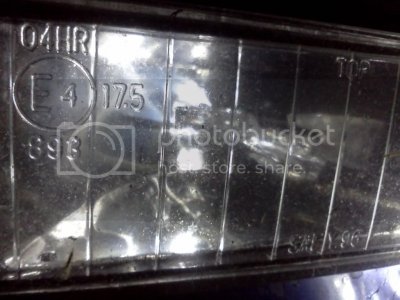

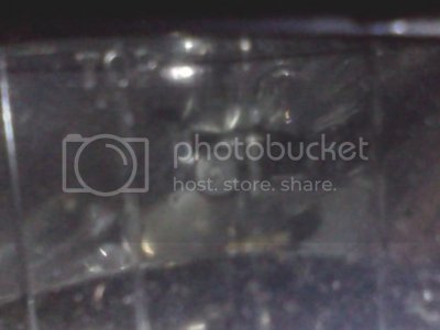

ok, this is what I could achieve tonight
Foglight1
Foglight
Just to make it clear, I did not do nothing with the lamp , just bulbs.
Art5
Sep 5, 2009
730
40
white plains, NY
I think bulb 880 would work a lot better though. Less work. If i remember correctly, i had to cut plastic from bulb base up to its capsule for top and bottom and the only thing was left is sides to hold it. Sorry, pics are crappy, did it with my phone with the help of a flashlight. It is wet everywhere, so couldn't get under the bumper.
