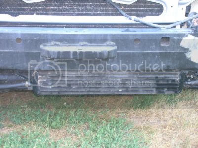

I have seen where some Gen 3 owners will add a Gen 2 trans cooler, what is the difference in the coolers of the Gen 2 & 3, and does anyone have any pics of a Gen 2 cooler?

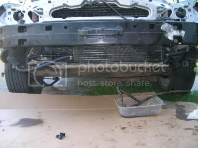

Here's mine installed. Though I still had issues at the convention at Grattan after about 4 laps.
Gen 2 atx cooler

Wow that cooler is nice, and those are factory Gen2 coolers!!!??? Why didn't Ford put a decent cooler on the Gen3 instead of the crappy un-finned tube?

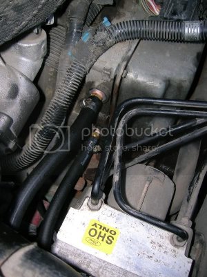

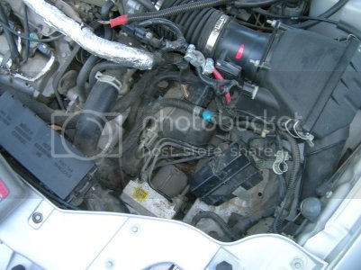

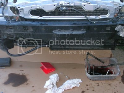

Funmart, the factory cooler is finned, and the unfinned one is for the PS cooler.

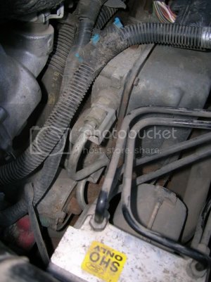

Mine is exactly the same as SHOZ123, except I did not use hydraulic hose for the small piece between the factory cooler and Gen 2 cooler.
I used a slightly longer length of hose to make the 180 bend.
And yes, the factory lines are replaced, and are not in place at all anymore. As I learned from SHOZ123 they are restrictive apparently.(?)

I will not lie to you. This is an extremely easy mod, and I recommend it. The hardest part you will ever encounter is removing the battery tray. Truly a PITA

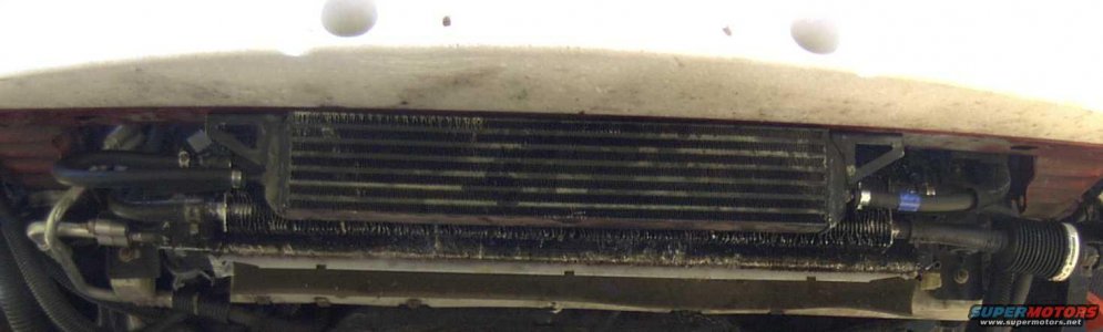

I have a question for all the gen2 coolers installed. I know shoz says he put in a filter (good idea) as with the used gen 2 cooler whatever problems the gen2 had with its trans is now flowing thru your trans. flushing will never get it 100% clean. why not just buy a good aftermarket cooler and remove the factory one. does anyone think pushing the fluid thru two coolers and a filter may be causing other problem's. By the looks of the pic's the gen2 cooler blocks the factory cooler I know it will get some air flow but it's cooling will be minimal in my opinion.
If you run the lines the right way the OE auxillary cooler is helpful. You want to run the lines so that you set up a counter-flow cooling system as opposed to a concurrent flow cooling system. Frankly I'm too lazy to go into a detailed explanation of the heat transfer theory involved, but here is a simple pictoral description of why counter-flow cooling is preferred:
Think of the red line as the transmission fluid and the blue as the airflow across the coolers. For our transmission line setup, we want the tranny fluid to run through the OE auxillary cooler first, then the Gen 2 SHO ATX cooler.

The OEM aux cooler helps somewhat as it is a bit more than just a tube. It has a swirling baffle inside and you would otherwise be using hose of a pipe to take it's place. I run through the OEM cooler then to my GEN 2 cooler.
Another reason not to get rid of it is it is part of the PS cooler mounting bracket. You could upgrade a bit and get a '99 one that has fins on it like the PS cooler.
I'm convinced my filter being in backwards was my temperature issues as I have ran this set up in the past and never even got close to 250F under similar conditions.

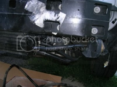

The 99 cooler is visible behind my Gen 2 cooler, you can see the fins:
NikonPhotos082
And Ray, I flushed the cooler out, then flushed it out with fresh cheapo fluid, and then put it in my car.
